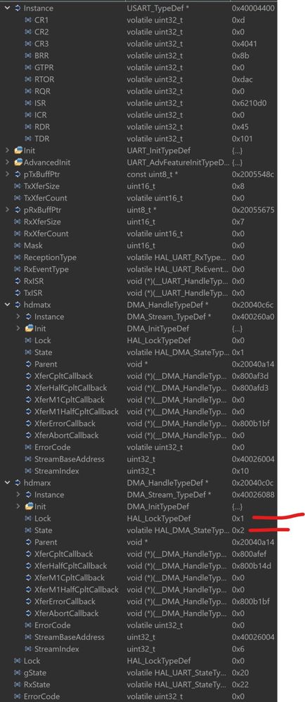

//Here breakpoit here for wrong data or no data, and once breakpoint here it show hdmarx lock and busy, check the attache image below for uart details.
}hdmarx lock and busy error

I'm not sure exactly why it was showing the lock before the HAL_UART_Receive_DMA() call. But the issue I observed from the slave side, which was not sending response to the master, and the master wait forever.
The lock may be because, the DMA waiting for big size buffer, and if the data not receive before x time then I do timeout and again initiate the transmit DMA, so their may be the case that, receive is not complete yet but due to timeout I do exit it forcefully which makes it lock that time.
Correct me, if my understanding is not correct.
