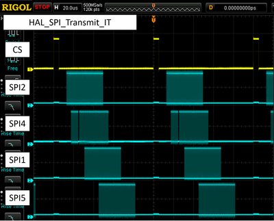

I recorded new SPI clock timings with only transmitting (HAL_SPI_Transmit_IT), and it's showing progressively delayed bus starts. What I'm seeing is that transmitting and receiving has delays, transmitting only has delays, but receiving only has zero-ish delay.
Transmit_ITTransmit_IT

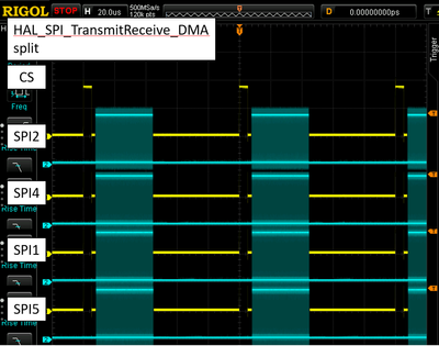

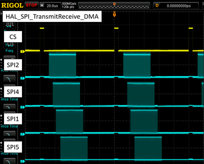

I came back to this problem and tried DMA to see if it's any better. Swapping the HAL_SPI_TransmitReceive_IT for HAL_SPI_TransmitReceive_DMA in the for loop for the 4 SPI peripherals yielded the composite image below. It completes the SPI transfer for all peripherals faster than HAL_SPI_TransmitReceive_IT, but you can see how the clocking out is still rather staggered instead of starting roughly simultaneously.

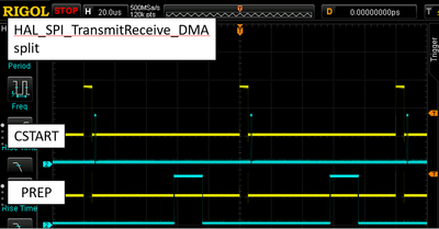

I then broke up the HAL_SPI_TransmitReceive_DMA into a prep function that has all of the code minus setting SPI CR1.CSTART bit and run that first. Then I call the trigger function on the timer's falling edge to set the CR1.CSTART bit for all SPIs. This resulted in the following composite image. Now all 4 SPIs clock out at the same time, which is what I want.
Splitting the HAL DMA function just shifted around the overhead. The image below shows the function duration for setting the CR1.CSTART bit and all of the DMA prep setup. (The SPI clocking out happens between the 2.) I calculate the prep functions take 20us of the 50us I have for processing the received SPI data.
The setup doesn't changed between SPI transactions. The transmit data is the same values and buffers, and the received buffers are the same. So I figure the SPI and DMA setup doesn't need to be changed. Therefore if I can restart the normal DMA transfer with some minimal amount of code, that would be ideal. Something like circular DMA but where I can start it with a software trigger (CR1.CSTART) or even an external interrupt. I have the timer pulse going into EXTI0, so I can do a falling edge hardware trigger as well.
Do you have any advise on how to restart normal DMA with minimal code? I'm trying to trace the HAL function interrupt calls to see what's happening, but I haven't figured it out yet.
