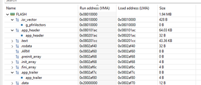

When i debug the application the code is running but the ISR are not working.
Here there is the memory map
The idea is to have 64kb for the botloader and the rest for the application.
The starting point of the application it should be at address 0x08010000
as usual in the main function i do this ..
Can you please tell me if you see something strange on the setting of the ISR table ?
Thanks a lot

Hi @Radosław and @Tesla DeLorean I have changed the linker in the following way but still isr routine are not working

Can you help me whta i am doing wrong now ?
Thanks
2024-05-20 12:25 AM
.app_header :
. = _APP_HEADER_OFFSET;
KEEP(*(.app_header)) /* Bootloader Header */
. = ALIGN(4);
} > FLASH
this looks wrong.
did you relocate isr vector in boorloder before you start app?
