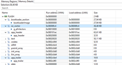

When i debug the application the code is running but the ISR are not working.
Here there is the memory map
The idea is to have 64kb for the botloader and the rest for the application.
The starting point of the application it should be at address 0x08010000

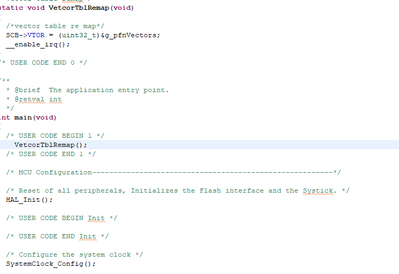

as usual in the main function i do this ..
Can you please tell me if you see something strange on the setting of the ISR table ?

Vector tables generally need 512-byte alignment, depends on interrupts implemented in NVIC.
You're approach is broken.
Define different/distinct MEMORY regions so it places the vectors at the right addresses.
Direct content and sparseness that way
/* Memories definition */
MEMORY
LOADER (rx) : ORIGIN = 0x8000000, LENGTH = 64K
FLASH (rx) : ORIGIN = 0x8010000, LENGTH = 2048K-64K
CCMRAM (xrw) : ORIGIN = 0x10000000, LENGTH = 64K
RAM (xrw) : ORIGIN = 0x20000000, LENGTH = 192K-4

Maybe you little missunderstand. Simple way is: Bootloader project no change load to 800000 maybe size to 64
app project change ld flash section start and size and in core src file system_stm32f4xx.c set
#define VECT_TAB_OFFSET .....in main no VTOR required.
