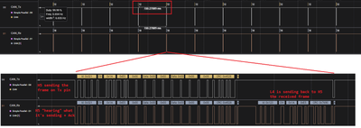

I'm adding screenshots from my logic analyzer:
If you can see the interval between frames are 150ms as I already programmed in the code and the frames on CAN_Tx and CAN_Rx are correct. So again no repeating behavior.
