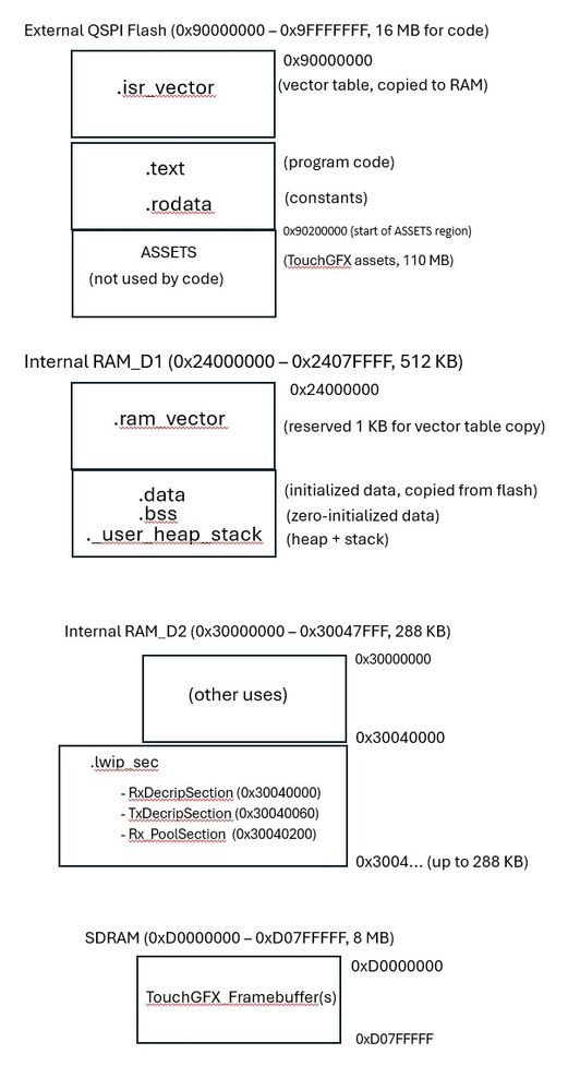

2026-03-13 12:08 PM
Based on your advise, please note this diagram of various memory regions usage to be adopted
please advise
