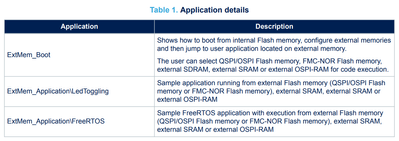

Please refer to the AN5188 "How to execute code from external memory on STM32F7 and STM32H750/H7B0/
H730 MCUs"
You can inspire from what was implemented on STM32H750B-DK board:
1- Boot application located in the internal Flash: https://github.com/STMicroelectronics/STM32CubeH7/tree/master/Projects/STM32H750B-DK/Templates/ExtMem_Boot
2- Any of the examples that are executed in the QSPI:  https://github.com/STMicroelectronics/STM32CubeH7/tree/master/Projects/STM32H750B-DK/Examples
