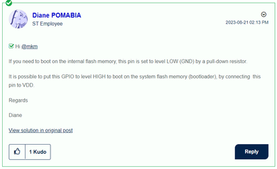

2023-10-04 2:21 AM - edited 2023-10-04 2:24 AM
2)Another question ,what about the boot0-ph3 pin, do i have to do something with it? This pin is now connected to ground. The configuration of this pin, does it mather to make the external loader to work in stm32CubeProgrammer?
