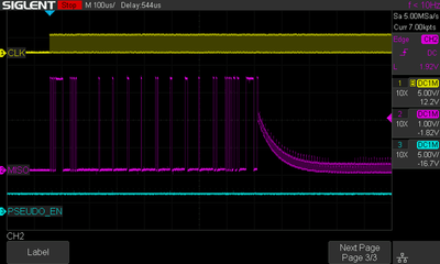

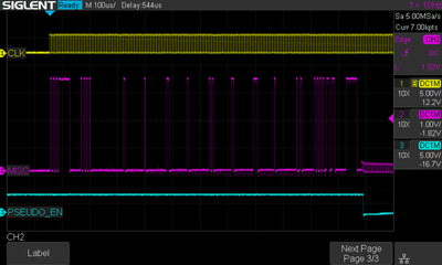

At 200kHz I get the correct frame out, and the callback triggers, sending channel 3 (PSEUDO_EN aka Green LED) low.
At 300kHz, I still get the correct frame out, but with 2 noticeable behaviors. First, channel 3 doesn't go low. Second, I get an extra high bit(s) after the end of the frame.
