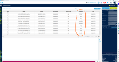

My external loader code(that i have posted) is based on the example MX25LM51245G_STM32L4P5G-DK you mentionned, and have already checked this MOOC also. I'm more and more thinking that my problem may lay on the memory settings.
I have checked other external loader examples and have noticed that the way the memory settings(specialy memory "page size", "sector size", "sector numbers") is done/chosen in "dev_inf.c" files is different for every memory manufacturer/chip and microcontroller(the settings doesn't always respect the datasheet). For example, for some memory-microcontroller, instead of using sector size(mentioned in datasheet), they use instead block size(that is mentioned in datasheet), i can't see any logic on how programming "page size" is chosen. All of the memory on the picture below have a maximum page programming size of 256(according to their datasheet), but when looking on smt32cubeprogrammer, some memory have page size much higher than 256, other have a page size of 0x10 = 16. What's the philosophy behind the memory settings? I really need help, i'm now two weeks stuck.
2023-10-03 9:39 AM
I would agree that there's a significant amount of inconsistency.
The Page size on the devices is typically 256 bytes, or 512 bytes when in parallel (dual banked). This is the size of the Write Buffer for lines within the device/array. At these sizes there will be a ridiculous number of sectors/pages.
It is more common for the Loader to report the Erase Block Size, which is often 4K, 32KB or 64KB, but depends on the specific device and trade-offs in terms of size, speed and operational efficiency.
Realistically the loader needs to manage the device quirks, so if using Page Write it needs to deblock and align those out of the data/length handed over to it via Write(). If the size of the data blocks is small there will be a lot of activity with the loader's Write() and potentially Init() entry points.
For 512Mbit (64MByte) devices I'd probably opt for 64KB erase / write blocks granularity. It potentially wastes space, but you can pack your binary structures.
For a FatFs type implementation I'd tend to 4KB blocks as a) the file system can handle them directly, b) the devices are better optimized to handle that, but still potentially quite slow writers. Managing 512 byte sectors, all the deblocking, and re-writing, would honestly be a nightmare at the DISKIO level.

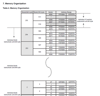

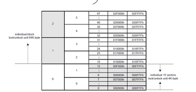

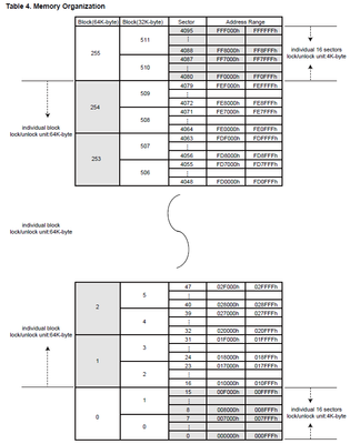

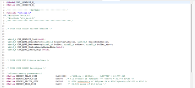

Thank you for your answer. For my case. My memory MX25L12833F is a 128Mbit = 16Mbyte flash memory. According to the datasheet of the memory, the memory has the following specs:
Device Size = 0xFF FFFF + 0x1 = 100 0000 = 16.777.216
sector size = 0xFFF +0x1 = 0x1000 = 4096
32K blok size: 0x7FFF + 0x1 = 0x8000 = 32.768
64K blok size = 0xFFFF + 0x1 = 0x10000 = 65.536
There's a picture of the memory organisation here below.
1)Wich device settings would you advise me to put in "dev_inf.c" file and in my quadspi.h file. So wich should i choose as sector size(4K, 32K, 64K) and page size?
