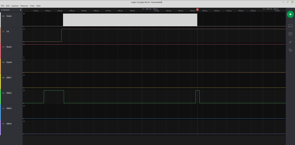

I don't actually have a HyperRAM chip on the Nucleo, but since the issue I'm currently having is that I can't get a CS or clock out from the OCTOSPI, I figured it wouldn't really matter if there wasn't anything connected to the STM32 to talk to. I just wanted to see those signals change on a logic analyzer.
As part of my debug process, I enabled a free running OCTSPI clock as I wanted to see if that would continue to be generated by the STM32 but I found that when MX_OCTOSPI1_Init() is called, the freerunning clock starts and then stops shortly afterwards.
Looking in further, it's actually stopping during the call to HAL_OSPIM_Config().
Here's what the signals are doing:
Clock and CS are the OCTOSPI signals. Reset is a GPIO to the chip (active low).
I'm setting/clearing DBG2 around the calls to HAL_OSPI_Init() and HAL_OSPIM_Config().
I see that the CS goes high and the clock starts near the end of HAL_OSPI_Init() which is what I was expecting. However, the clock stops in the middle of the HAL_OSPIM_Config() call. That I wasn't expecting.
Is this a valid test? That is, should I expect the free running clock to stay running after the configuration of OCTOSPIM?

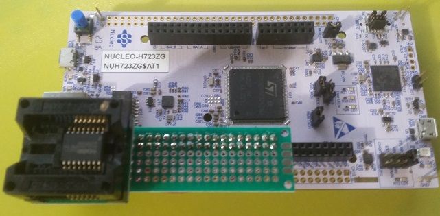

Not personally using the RAM devices, but I have fixtured a SOP16(W) socket to the NUCLEO-H723 for QuadSPI devices (Micron, Winbond, Macronix).
I think I'm working with a different subset of pins, and at least one on the header looks to be potentially conflicted, or have a stub.
I think all the pins can be pulled from the connector to implement an OCTO device, I'll pull the pin diagram when I get back to that system.
