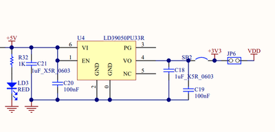

Where is the ~160uA going on the board

Schematic should guide you on where to look.
Looks like you are backpowering U4 which is surely drawing some current. Removing SB2 would solve.

ok, will try to remove SB2 cleanly - it's on the top side next to some C and i have no good SMD (un)soldering equipment. will report.

i removed sb2 and now get , with the same code that goes to standby, roughly 1.85 uA consumption.
a) that consumption is fine
a1) it would be great if sb2 was a (mini)jumper
a2) would not have expected that U4 consumes that much current when backpowered, but i'm a software developer
