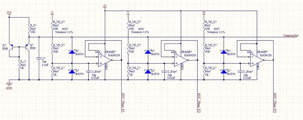

BTW - Here is my updated schematic. I have added the buffer opamps and moved the clamp to the input of the opamp rather than Vout.
I am running the opamp at 5V now to stop it going into overload if signal ever peaks above 3.6V (has a 3.3ms overload recovery time). Also because the input is a square waveform, I've added in a filter cap C_filter to filter out some noise on the otherwise DC (once settled) signal. Having some difficulties sizing it though, because I'm confused of its time constant due to the resistor in parallel. I want it as large as possible with maintaining a 5*RC < 2.25uS (slew time of the opamp)2012-06-15 2:11 AM
