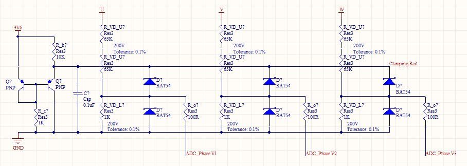

I'm designing a 3-phase DTC induction motor control which needs the 3-phase voltages and 2 of the currents. I am using the STM32F4 Discovery board. The control will have a small sample time (5uS). The controller may issue a new switch state every 5uS, and therefore the 5 ADC must take place every 5uS. Assuming due to the inductance of the motor the voltages/currents will need, lets say, 2.5uS to settle. Therefore i have only 2.5uS to do these 5 ADC's. The control loop is highly sensitive to these 5 parameters, therefore the more accurate the readings the better. Also, it is best to do these readings as close (in time) to each other as possible. I see this STM32 chip has many ADC setups, so what is the best method to go about this? Ideally it would be good to have a synchronized trigger just before my main control loop to read all the ADC values into DMA, then I can just read the values without interrupting the flow of the code. Is this going to be too hard to get them sampled within a reasonable time? Another alternative is to just use the DC bus voltage and switch states to estimate the 3-phase voltages. Although this is mathematically less accurate, perhaps just having 3 ADC conversions (DC bus voltage, and 2 currents) will end up a more accurate solution? Also, my UVW phase voltages will be 0~400V . I was thinking of scaling the voltages 130:1 (max 468V) and clamping using the following schematic. Thoughts? Im not sure what value i should use for R_o.2012-06-14 12:05 AM

Your scaling is 131:1.
Ro should be a unity gain operational amplifier to provide a low impedance input to the ADC. Otherwise, the sampling time would have to be too long to get an accurate conversion. If you go with just 3 inputs, triple simultaneous mode will provide the best performance. See the example for this mode provided with the standard peripheral library. For 5 inputs, consider triple simultaneous mode with two channels per ADC. Cheers, Hal2012-06-14 5:38 AM

Yes I have already made the change to a unity opamp, I realised that mistake shortly after my first post. Will the triple simultaneous mode with 2 channels per ADC result in a conversion time as per my previous post? What prescale of ADCCLK should I use for my 200khz square wave? The shortest pulse will last 5uS, but I want to allow at least 2.5uS for it to settle and my filter cap to charge. Thanks for your help so far.2012-06-14 7:29 AM
