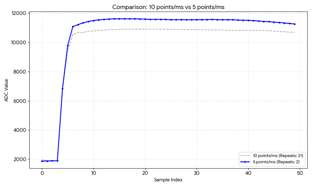

However, I observe repeated ADC values (e.g. A, A, B, B…) instead of updated data at each 100 us read.
Reducing the application read rate decreases the number of repeated samples.

2026-01-20 6:21 PM
Set the values to 0 after you read them to ensure they are updated the next time around. If you still get duplicates, that's what the ADC is reading.
Ensure you have data cache disabled or are managing it correctly.
It would be better to double the buffer size and use the half-full and full interrupt to process each half of the buffer. Otherwise you have race conditions as the ADC is updating the same portions of the buffer you are reading.
