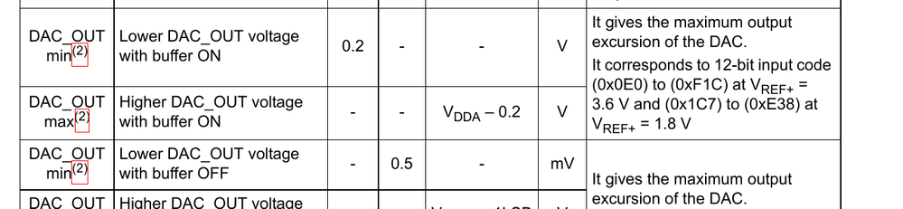

there is no "issue" , the DAC doing , what it should do; if you would read the ds, you could see:
And this you see , when DAC data = 0 .
> Is ~0.05 V at DAC output a known/expected behavior for STM32F4 DAC or specifically on the STM32F4DISCOVERY board?
As you could see from ds : yes.

You have the Output Buffer enabled, so Yes the voltage is normal and can only be reduced by disabling the Output Buffer, but then You have to buffer the DAC output by yourself (DAC output impedance max. 15 kOhm!).
