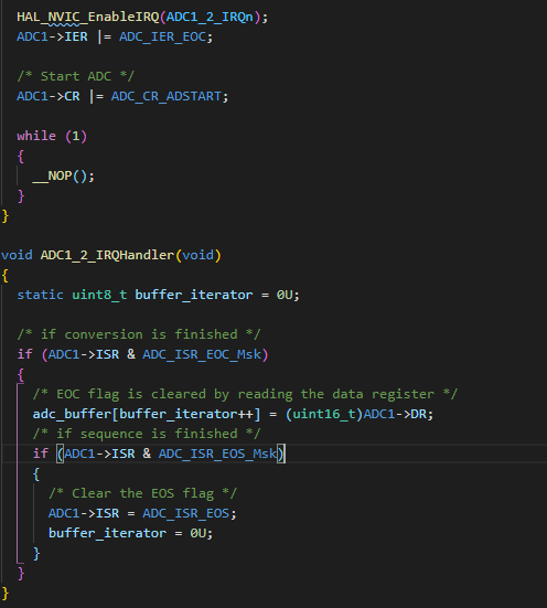

Hmm, no it doesn't actually. It worked as I used (EOC-) interrupts for it, however I want this to be independent from DMAs and Interrupts

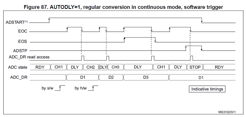

This figure suggests your original logic would work just fine:
Probably something else you're missing.

>> Don't you observe it in debugger?
> I do
Okay so that's why the conversion doesn't stay in the DLY state - you read out ADC_DR by the debugger, thus clearing EOC. Exactly as in the "classical" case of UART and SPI I am talking in that link, and discussed here so many times.
Stop observing ADC by debugger, observe only the memory where the program writes the data.
