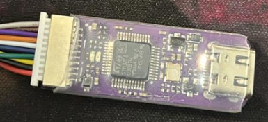

3- What kind of hardware tool you are using to connect to the board? STLINK? Could you please take a picture of your probe and share it with us?

3) Yes, STLink is probably modified with the original ST chip.
If the problem is with the cable, I don't think it's a problem because when I tried it with the same debugger and cable with the same chip but on a different board, it worked.
https://github.com/WeActStudio/WeActStudio.MiniDebugger

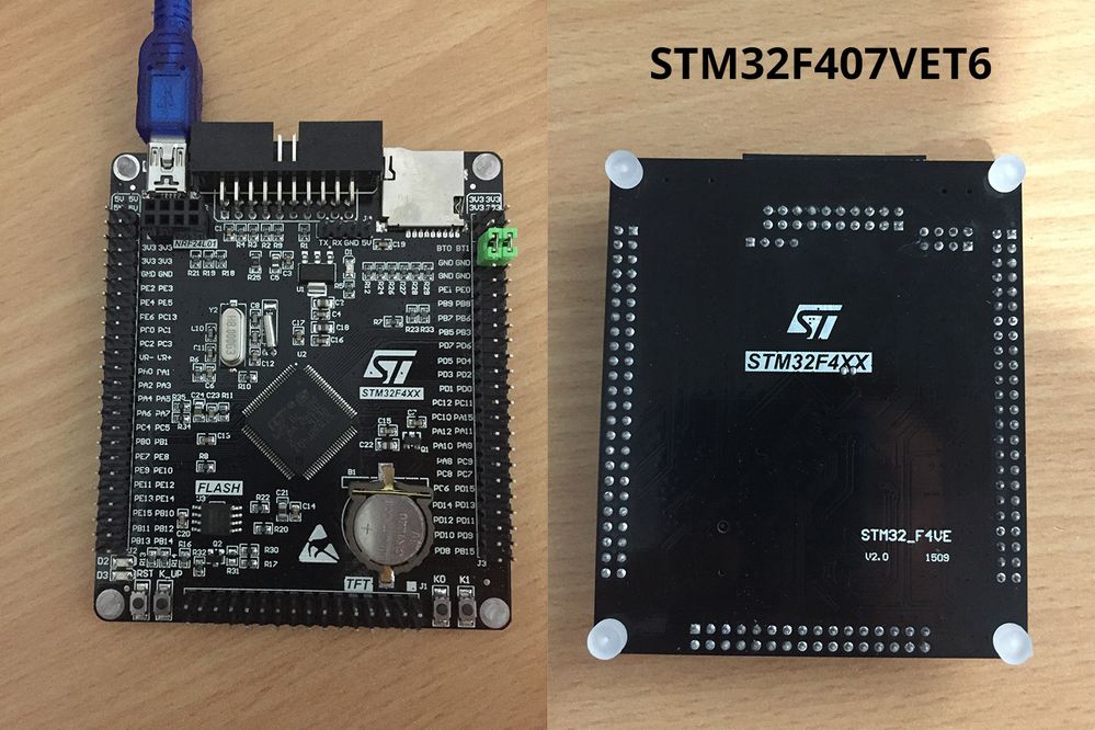

Does ST release a project board for STM32F407VET6?
2026-01-01 3:37 AM

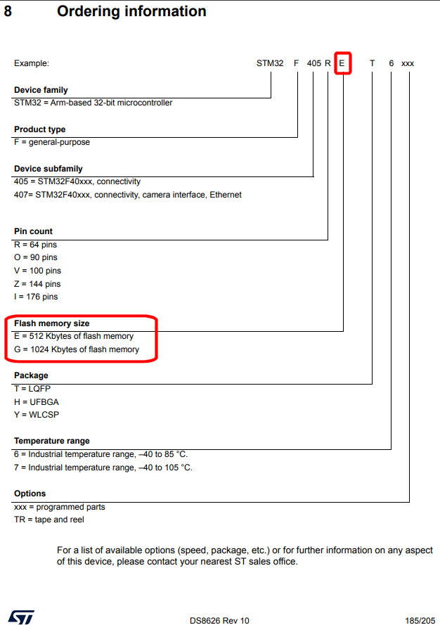

The way to find out would be to go to the STM32F407VET6 Product Page, and look on the 'Tools & Software' tab:
https://www.st.com/en/microcontrollers-microprocessors/stm32f407ve.html#tools-software
It suggests the STM32F4DISCOVERY Discovery kit with STM32F407VGT6 MCU.
The only difference between VET6 and VGT6 is the Flash size:
https://www.st.com/resource/en/datasheet/stm32f407ve.pdf#page=185
via: https://www.st.com/en/microcontrollers-microprocessors/stm32f407ve.html#documentation
