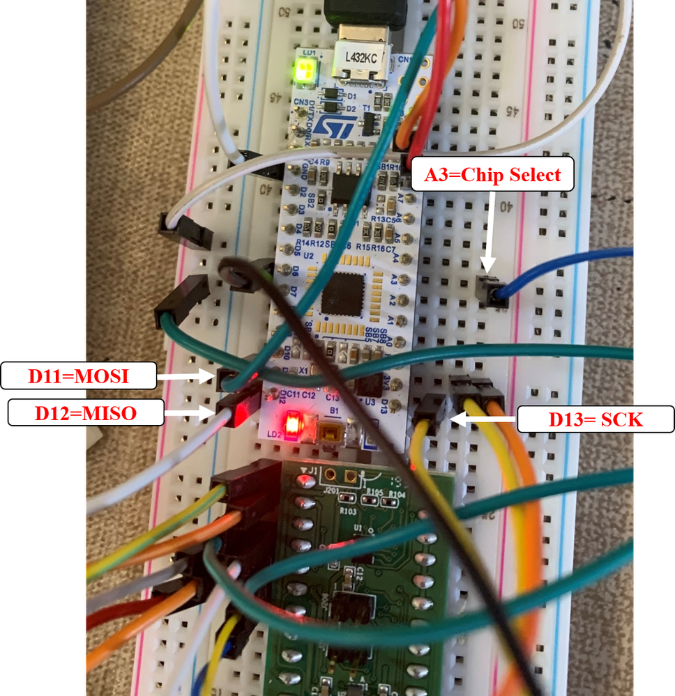

Thanks for your reply. Please kindly find the pin connections for SPI connections.
Also, the piece of the code that I am using to get gyro data is as follows. In this code, I followed the procedure explained in the Bosch GitHub, here. The problem here is that it doesn't update the gyro variable. Also, tested with the logic analyzer. Seems it is not changing on the pins.
Thanks

Would have chosen I2C myself.
How have you got it connected? Written any software for this, or expecting others too?
Some SPI interface examples in the BSP code for the example boards, try porting that into your target.
If pins are not sending the signals, ensure they're configured correctly. Look at the GPIO registers. Looks like Arduino code, which I'm not really familiar with.
2020-07-28 3:35 PM
Yes, this program is written in Arduino IDE. It compiles but doesn't work.
Am I following the right procedure here?
