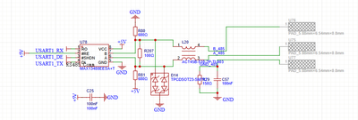

I use a autodirection rs485 tranciever (5V on FT pins) and it is working on many of the boards with no problem, also the in-application code works fine for modbus (also on the bootloader broken devices, after programming with ST-Link)
I am using a FTDI USB to RS485 converter.

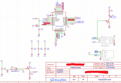

The boot pin is held up by a hall sensor and inverter transistor, i have noticed these sensors has different startup time 50-100ms - therefore the MCU reset pin is controlled by a rather slow RC circuit, to ensure boot is high before reset is released. (this is a litle risky).

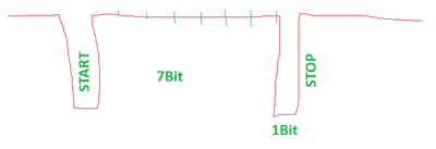

I can see on the RX pin of the tranciever it recieves the 0x7F from cube programmer and i can measure it close to the MCU pin (UFQFPN). But there is none answer from the MCU on TX pin.

I have tried to run the PC of battery, short the pc and lab psu together to ensure common mode voltage, but the recieved signal out of the tranciever looks good, and equal to a working device, i calculated baudrate/timing and it was ok...

There is added pullup between pin 2 & 3 on the rs485 tranciever 10K.

On a board that has the problem, plot BOOT0, NRST, and UART_TX, UART_RX on a scope. You will find the issue.

For the RX/TX, on TTL level, Trigger on RX, the signal starts high, then there is a single start bit, and in the end before the high stop bit there is the 1 bit low... It is 5V signal, have nice edges and low level below 0.5V.
according to chatty the timing fits, from first falling to last falling and 8bit time.
On TX pin there never comes any signal :(
For the Boot0 vs NRST, as you can see by the RC timing the reset raises slowly.
The time Boot0 goes high the NRST has been seen between 0.7 to 1V, remember the NRST has the schmidt trigger.
However i was afraid this was the problems, so have tried with same result to connect boot0 to 3.3V, and afterward to remove the big reset cap (with boot0 high) and still issue.
