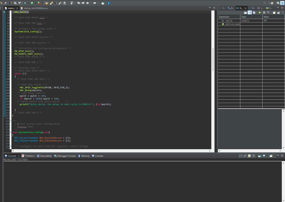

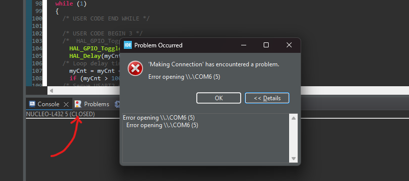

still pretty, pretty new to STM32CubeIDE, I'm trying to understand how it works by doing little things. So right now I'm trying to combine both debugger with a terminal both running in STM32CubeIDE.
To include terminal in STM32CubeIDE I have followed instruction given here:
How to use the STM32CubeIDE terminal to send and receive data (Knowledge Base)
So far, running a little test program, I was succesfull doing it at least for very first debug session (i.e. after power cycling the Nucleo-Board). I quit the debug session with the indicated button shown on attached figure below
However, when I start a debug session a second time, I get always(!) the same error message (see below)
The only way I found so far is to make a hard power cycle to the Nucleo-Board to make it connected in the STM32CubeIDE again.
Well, in STM32CubeIDE, because I also installed Tera Term and here everything is working fine. But actually I'm a fan of having thing in one application that can be in one.
So my question is: Is there a better way of connecting the terminal again in STM32CubeIDE after quitting a debug session?
Regards
Sebastian
Win11, STMCubeIDE 2.0, Nucleo-L432 Board

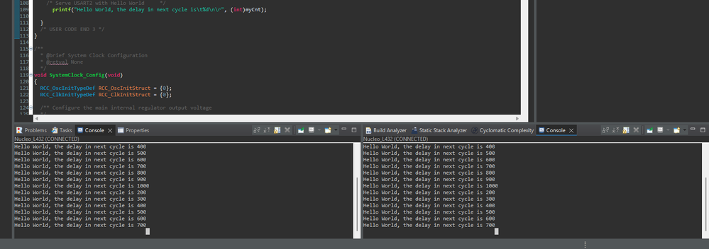

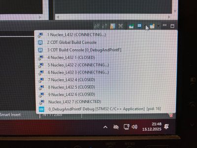

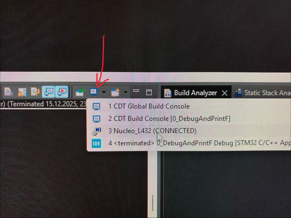

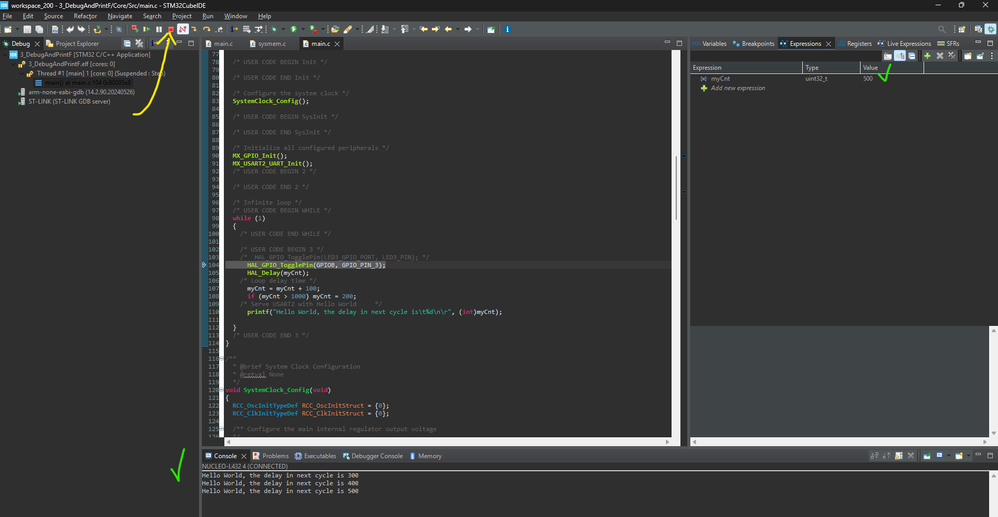

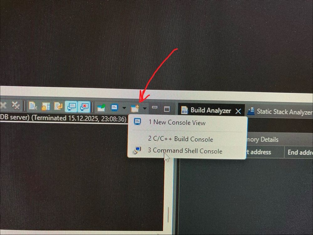

ooooooooooooooooooooohhhh. I guess I found my mistake (aarrg, why the icons in STM32CubeIDE are so small) - so I had a look on the linked discription again where it was said:
"This also works while in debug mode and you can switch the “Console view” by clicking and expanding this icon"
... I thought the icons are the same. But actually the are not.
So, for the very first connection (either in editing or debug mode), one has to click on this icon (sorry for screen shots again):
Click on "3 Command Shell Console"
Then, once the connection is established, one need to select the console to display for any further view by clicking on the icon just left to it and select it (screen shot below).Under 3 the connected Nucleo_L432 (name I have choosen) an be selected
I leave the pictures large to see the icons in a better way.
... and now I don't know where to place the solution marker. Thanks to Andrew Neil and Pavel A!

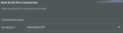

2025-12-14 1:31 AM
if the serial (IDE) console looses connection : check if the system (Win11 here) causes this, just open new -> serial console -> new...and see, what the system offers to connect (the small down arrow )
Then open with new name with this port.
I had this also sometimes, but dont ask me when it happens (on Win and Linux - same), long time ago ;
on IDE 1.18.1 here, same on 1.17. , 1.19. , just 2.0. not using , so dont know; but should be same.
btw
I always use the built in console ; its nice to see whats going on one or even on more than one connected boards,
while editing the program(s) , on the same screen.

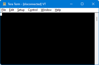

2025-12-15 12:56 PM
@DSebastian wrote:
@Andrew Neil wrote:Can any other terminal connect to COM6 (or whatever) when the IDE is in this state?
No, starting (sic?) TeraTerm after IDE being is not possible.
It shouldn't affect starting TeraTerm - should just mean that TeraTerm can't open the connection?
TeraTerm should say something like:
or
and then open in 'Disconnected' mode:
2025-12-15 1:19 PM
Well, it reproducible with the steps described:
With respect to spawn another instance, this might be actually the case, because looking into details it looks like attached one can see that several instances appear (sorry for the screen shot, but drop down menus close when application is switched).
Probably one more hint/idea from my side:
When I open a new console prior to switching to debug mode, and make this new console a "Command Shell Console", then I get, hm, two consoles showing the same (see below)
But one of the consoles disappear when I start the debugger ... and connection is lost
Don't know if this is important, but for debugging it switches into perspective view.
So, far I no further ideas what to share.
2025-12-15 1:26 PM
Yes, this is what it does:
and then opens it diconnected mode

I do not get that far. When I try to open a new console I get the error message
2025-12-15 1:33 PM
"Access denied" means that something else already has it open.
So it sounds like your initial debug session is not properly closing the connection - that's why subsequent sessions can't connect.
When you say you "power cycle" the target, I presume that means you disconnect the USB?
That would cause the connection close - so your next session would work.
