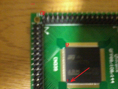

Are you sure it is correctly orientated? ie Rotated with respect to Pin 1?
Attach a picture (use macro setting, have it focused)2014-04-21 12:23 PM
2014-04-21 12:35 PM
Yes, so you've got the orientation wrong
2014-04-21 12:58 PM
Thank you..It worked .... I was confused by the logo orientation on STM32CubeMx...I didn't see the circle markation... Thank you again
