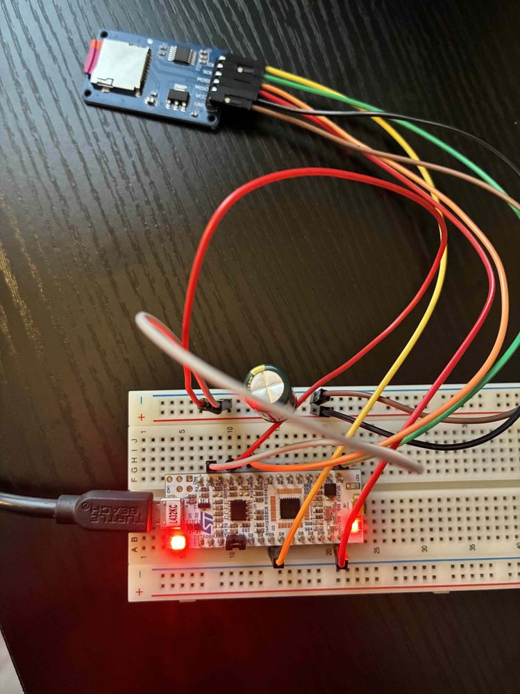

I'm working on a data logging project using a NUCLEO-L432KC board and a standard Micro-SD card module.
I have a very frustrating issue: Reading from the SD card works perfectly, but Writing fails immediately.
MCU: STM32L432KC (Nucleo-32 board)
SD Module: Generic MicroSD Card Module (with 5V to 3.3V regulator and level shifter).

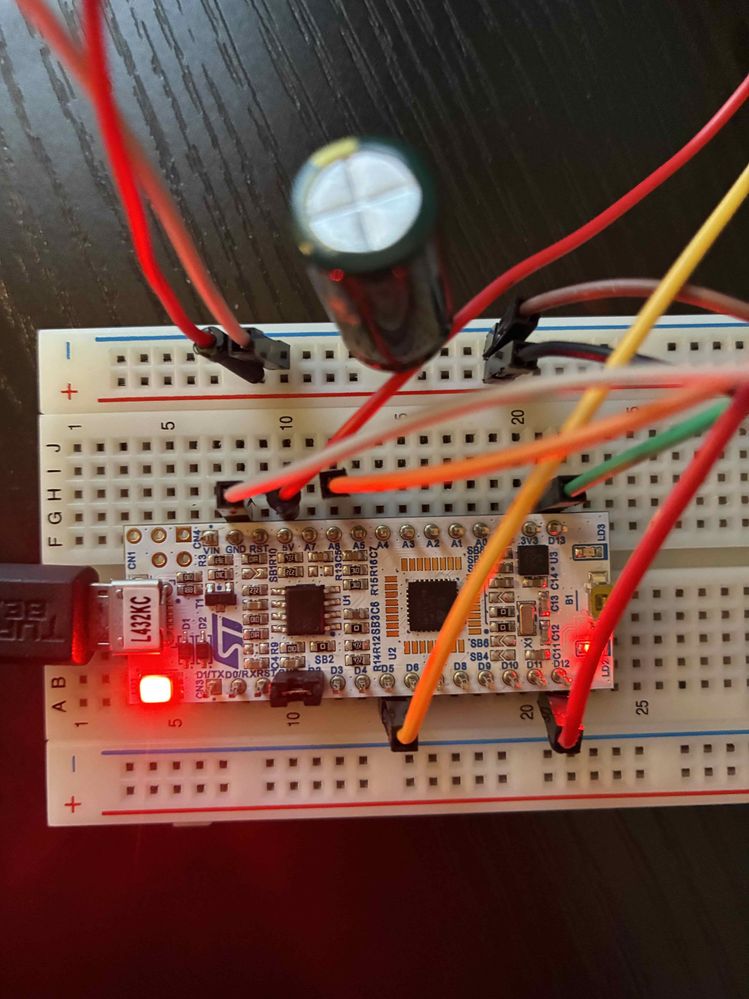

Power: Module is powered via the 5V rail from the Nucleo. I added a 1000µF / 25V electrolytic capacitor in parallel on the breadboard to prevent any power drops (brown-outs) during write operations.

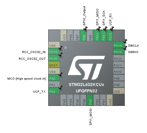

Pinout: * SCK: PB3
MISO: PB4
MOSI: PA7
CS: PB6 (Software managed)

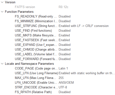

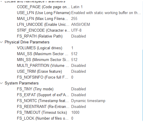

Library: FatFS R0.12c (via STM32CubeIDE).
FatFS Config: _FS_READONLY = 0 (Disabled), _FS_LOCK = 0.

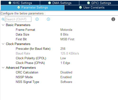

SPI Config: MSB First, CPOL Low, CPHA 1 Edge, Baud Rate 125.0 Kbits/s for init.

Signal Integrity & Speed: I am currently running at the slowest possible speed (Prescaler 256, approx 150kbps) to rule out wiring/signal quality issues. Reads are working perfectly at this speed (I can read the full file content).
