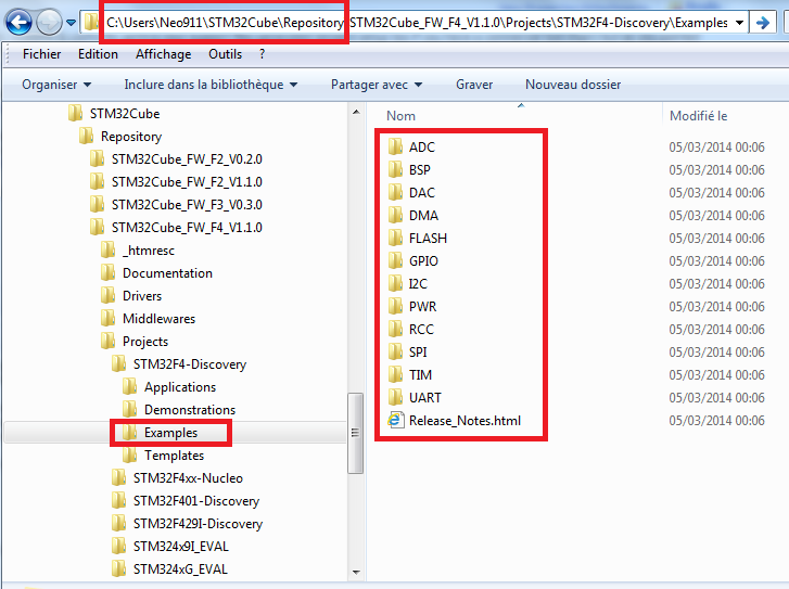

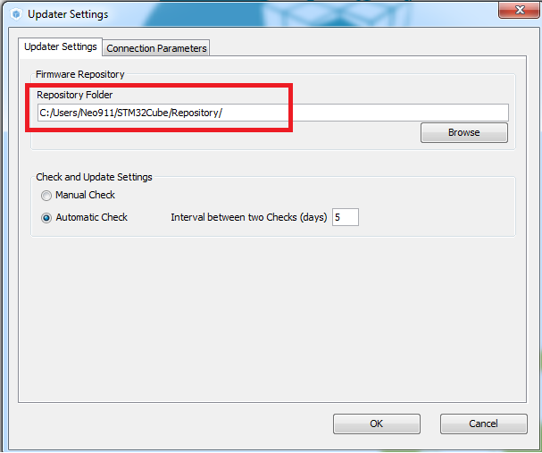

As far as I can see, the CubeMx library installer, after downloading it, puts for instance the STM32F4 package in your ''repository'' (see User Manual, 3.5.1, ''Updater Configuration''). One can get the default settings by selecting the ''Updater settings'' choice in the ''Help''menu.
