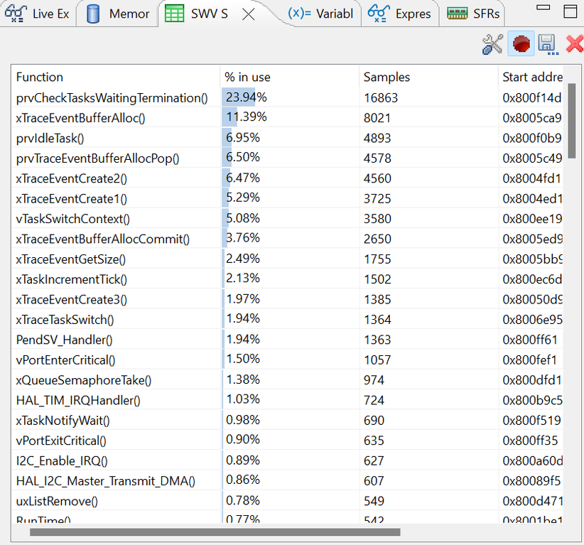

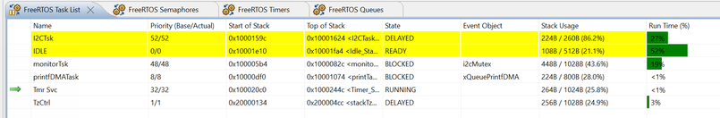

The Run Time counters and stack usage is shown below:

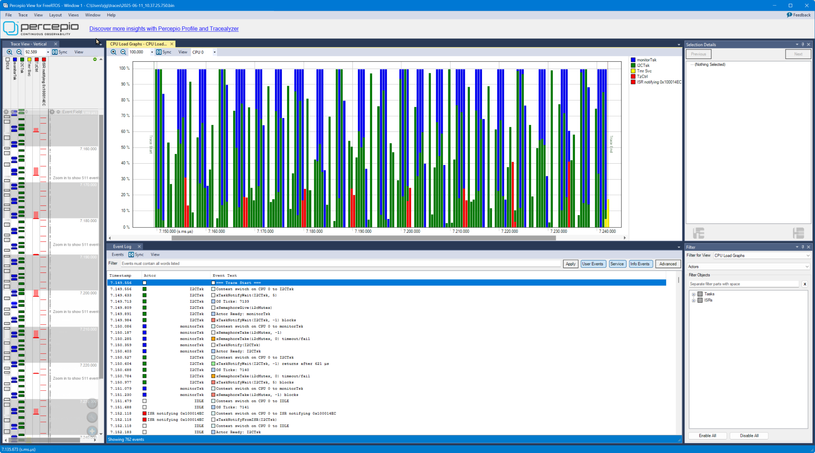

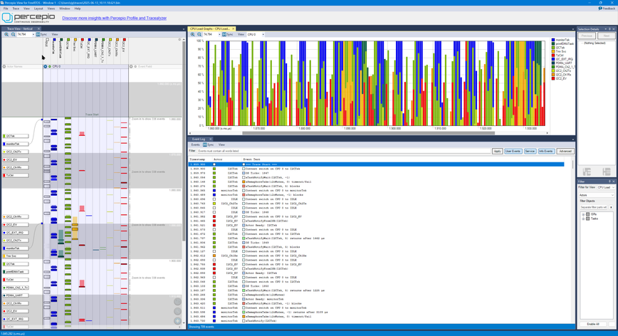

Here is a trace of my PixiPuss program
Works very well. Of course the one I'm using is the free version which is limited to snapshot recording with the Trace Recorder ring buffer. I an getting a quote for the full version, but somehow I think the price will be far too high for a retired hacker like me.

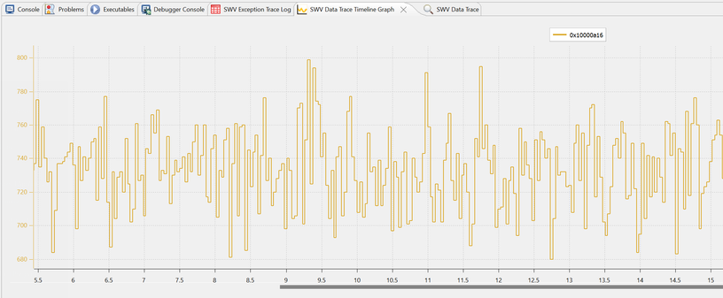

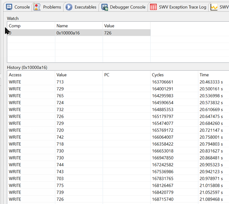

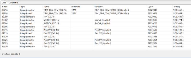

Here are outputs from the SWV functions you can use:
Using one or more of all of these tools can make debugging like fox hunting, and they enhance "the thrill of the chase."

Looking at the Tracealyzer output I found a coding error. I had a vTaskWaitUntil call in my monitor task main loop which was unnecessary as the VL53L4CD provides the timing. I removed the wait and the lastTick value and changed the timing of the VL53L4CD to
#define POLLING_PERIOD (20U) // refresh rate for polling mode (ms, shall be consistent with TimingBudget value) */
#define VL53L4CD_TIMING_BUDGET (19U) // Timeout for I2C operations (ms)
