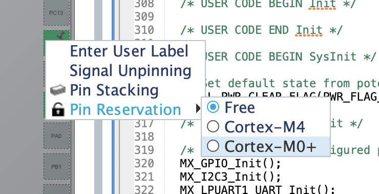

Now, back to my main problem. I tried to wake the CPU2 in line 24 by using an external interrupt (EXTI). But I must admit I even failed to configure it... Sure I configured a pin as GPIO_EXTIx but in NVIC2 all the EXTI lines are grayed out, for BOTH CPUs (=NVIC1 as well). I have seen other assiging the interrupt pin to a certain CPU like so:
But this option is not available for my GPIOs? The picture shows its for an I2C pin, which i can't select anything. No matter what i press, it always shows 'free'???
So I tried to configure everything manually:

So why doesn't the configurator allow me to asign various GPIOs to individual CPUs (incl EXIT) and why isn't the code generated? I am missing something here?!

Ok I am a little further.
First I found the trick to make a single core project out of it. Right in the beginning of the project setup... quite hidden.
NONETHELESS I'd really would like to understand the dual core config stuff: why I can't even get a simple GPIO generated automatically AND how to configure interrupts (EXTI lines) properly. So please tell me.
