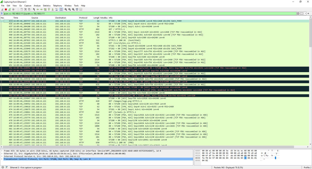

during testing a custom project with NETXDUO on NUCLEO-H563ZI I've noticed that sometimes web server response is rather slow.
Wireshark shows rather frequent TCP retransmissions and other problems.
To be sure, I've tried an example from ST (Nx_Iperf) with the same result.

2025-05-29 2:12 AM
For everyone who curious following settings have fixed TCP transmissions for me:
ETH_TX_DESC_CNT=8
NX_WEB_HTTP_SERVER_SESSION_MAX=4
NX_WEB_HTTP_SERVER_MAX_PENDING=8

2025-05-29 3:36 AM
Hello @sssooo
just to add few points based on our internal conversation, so other users can see it.
The ETH_TX_DESC_CNT will reduce the re-transmission due to no TX DMA descriptors being available to send packets.
The HTTP settings affect how much TCP connections can be opened at the same time. Web browsers will typically open several TCP connections with the server. When additional TCP connection can't be established the client will try to retransmit the request to open the TCP connection.
At the end it is tradeoff between performance and memory allocated to TCP / HTTP stack.
