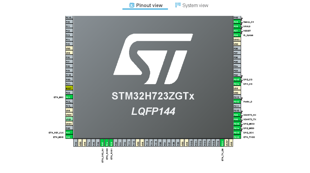

2026-03-23 4:23 AM
It could likely be that some ethernet pins are not configured correctly. Could you please show the Ethernet pin configuration from CubeMX or attach the ioc file?

2026-03-23 6:03 PM
2026-03-23 6:03 PM
Currently, both D-cache and I-cache are disabled.

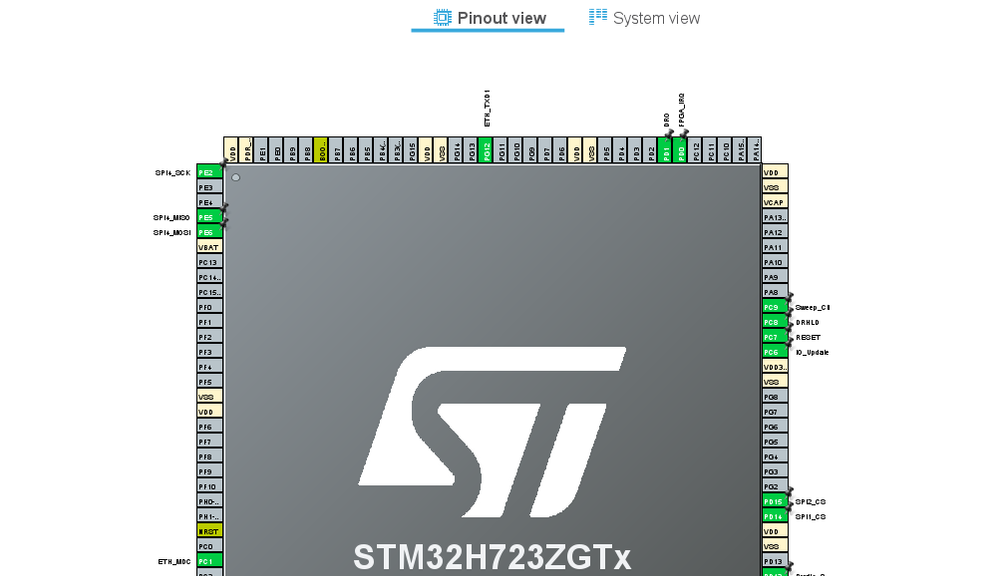

2026-03-24 1:28 AM
I can see the TX pins are not the right ones. TXD0 should be PG13 instead of PB12, TX_EN should be PG11. Please check all the pins and compare with the board's schematic. I am running an example on my Nucleo H723 with these changes and all works.
2026-03-24 7:35 PM
Thank you for your response and for pointing out the pin configuration differences.
I have reviewed the Nucleo-H723ZG schematic and updated the pin assignments accordingly. Specifically, I have corrected the RMII pins as suggested (TXD0 -> PG13, TX_EN -> PG11, and TXD1 -> PB13 ), and verified the overall pin configuration in my .ioc file to match the board schematic.
