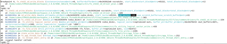

Hi, thanks for coming back to this on short notice. We have been working from the example code on, there is no CubeMX support file, but I think we have enabled the right settings in the code.
If you could have a glimpse at the stack trace, you can see that the application code sends 100-300 sectors in one go (160 in this example) that are passed up through the filex stack as expected.
It is the stm-provided fx_stm32_sd_driver.c file that splits it into single-buffer writes in a loop, which is not what it should be doing. Could you point us to the latest version of that file?

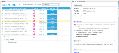

Also, for the N6, I don't see a specific ThreadX support package - which one would be the one to use from:
Thanks a lot
Simon
as the N6xx is M55 core - this should be the package you need.
(Dont see it in your Cube pic...so look on git -> M55)
