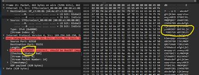

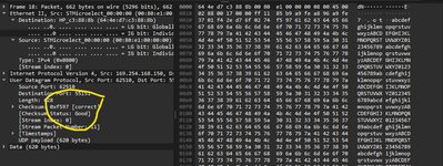

I am currently experiencing some unusual Ethernet transmission (STM to PC) issues with a few of our custom PCBs. We use the STM32H753II chip and the KSZ8081RNB. The KSZ8081RNB is connected to the MCO2 and the RMII-interface of the STM.
The IP/TCP/UDP checksum check primarily fails due to corrupted payloads ranging in size from 1 to 20 bytes, or, more rarely, due to corrupted protocols. It doesn't happen regularly, but it happens too often.
This means that, for TCP, two or more retransmissions are sometimes needed.
udp bad:
udp good:
Sometimes, packets with complete defects are sent. These defects are not sent by the application. Even, when I paused the application, I could still see these packets.
For tests the PCB and the PC are directly connected. Using different cables does not solve the issue; only using different PCBs does.
I set up the LwIP example project in CubeIDE 1.19, as described in Github STM32H7-LwIP-Examples#how-to-create-project-from-scratch.
This project's firmware was used to create the traffic shown in the pictures. After increasing the payload size from 20 to 620 bytes, I noticed the issue occuring more frequently.
