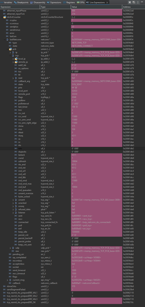

if ((tcp_rexmit_rto_prepare(pcb) == ERR_OK) || ((pcb->unacked == NULL) && (pcb->unsent != NULL))) {statement (which is present in tcp_slowtmr() function). Once it happens, the debugger shows that:
TCP PCB shown in debugger
It's the tcp_rexmit_rto_prepare(pcb) condition that allows program to go into the if statement. Also, as debugger shows, nrtx is equal to 0, which means there were no retransmissions in the last 5 minutes (rtime=575, which is 287 seconds).
