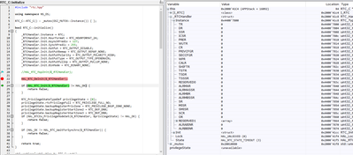

2025-09-12 4:16 AM
Deinit fails because HAL_RTC_Deinit calls RTC_EnterInitMode which causes HAL_TIMEOUT as HAL_RTC_Init so the state is HAL_RTC_STATE_TIMEOUT:
