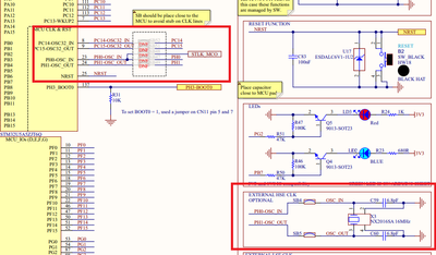

Thank you for the sharing.
It seems to be an issue with that default config.
Please try the configuration I shared previously. According to the board's schematic, HSE is not using Bypass mode (For STLINK MCO output) but a crystal of 16MHz:
As you can see in the schematic, STLINK-MCO is disconnected by default and the default configuration is a Crystal of 16MHz.
If you confirm that, I will raise a ticket to fix that in CubeMx.

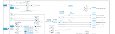

Here is a snippet of the default clock config:
- System clock is set to 16 MHz
- HSE at 8 MHz is used as clock source.
- HSE enabled as "BYPASS Clock Source"
Aren't these settings weird as a default for the Nucleo board? I would expect 160 MHz as the sysclk. Also, changing HSE to "Crystal/Ceramic Resonator" seems to fix the error in SystemClock_Config().
