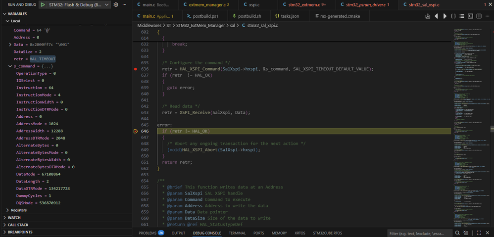

staus_psram return with EXTMEM_ERROR_DRIVER and it came from the HAL TIMEOUT from STm32_sal_xspi.c
XSPI_Receive somehow returns with HAL_TIMEOUT. I increased the timeout to be 1000, but without any success.

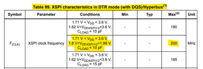

The XSPI clock speed 200MHz is the maximum clock speed supported. You must therefore respect the hardware and the software constraints to achieve this frequency.

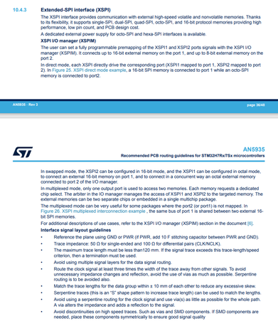

For that I recommend you to refer to Getting started with STM32H7Rx/7Sx MCUs hardware development - Application note application note to check you hardware:
