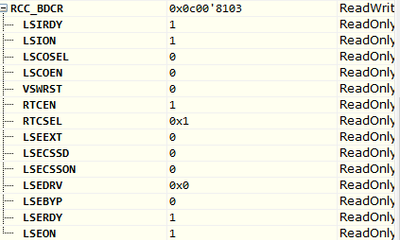

2025-09-11 2:24 AM
This is the value of RCC_BDCR:

Can you check the status of the RCC_BDCR register when this issue happens ?

2025-09-11 2:24 AM
