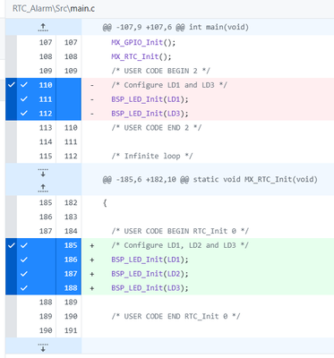

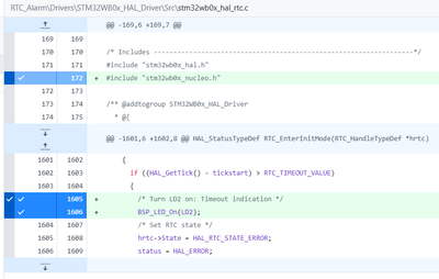

5) Optional: to confirm the specific failure point, make a few small changes to the code so you can observer LED1, LED2, and LED3 on the CN3 and CN4 headers.
- Call BSP_LED_Init() at the beginning of MX_RTC_Init() to ensure the GPIO signals are initialized before the failure occurs:
- Update stm32wb0x_hal_rtc.c so that LED2 is turned on when the RTC initialization timeout occurs:
- Now build and flash the updated code onto the board, then repeat step 3) above. Now you will see:

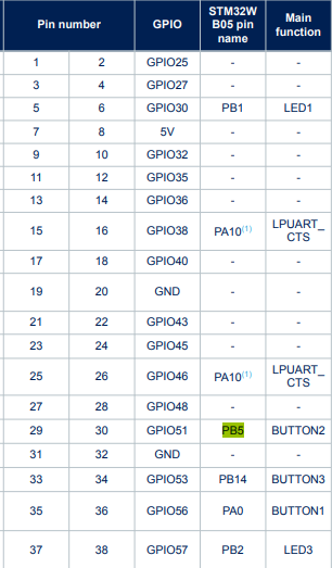

Also, just to clarify: on the Nucleo‑WB05KZ, LED1 is normally mapped to CN3 pin 51, not CN4 pin 6, so I’m not sure if that’s just a typo in your description or if you’re probing a different signal.
It worked for me when i used the pin51
