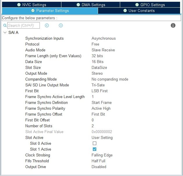

2023-02-08 4:17 AM
Thank you for your response.
I am setting from IOC file by referring to SAI_AudioPlayback code.
The following is the configuration of the ioc file
The following is the code that performed [generate code] from the ioc file.

I don't know where [hsai_BlockA4.Init.PdmInit.] in the code above is in the IOC file.
That part is different from the part in the SAI_AudioPlayback code, but I don't know where to modify it in the ioc file.
Please let me know where to fix.
