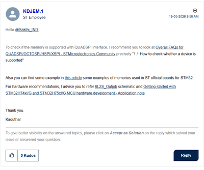

KDJEM.1
Hello @Sakthi_IND;
To check if the memory is supported with QUADSPI interface, I recommend you to look at Overall FAQs for QUADSPI/OCTOSPI/HSPI/XSPI - STMicroelectronics Community precisely "1.1 How to check whether a device is supported"
Also you can find some example in this article some examples of memories used in ST official boards for STM32.
For hardware recommendations, I advise you to refer 6L2S_Outjob schematic and Getting started with STM32H74xI/G and STM32H75xI/G MCU hardware development - Application note
Thank you.
Kaouthar

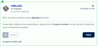

Ok. So please accept as solution @KDJEM.1 post then..
mƎALLEm
Not this one:
But this one.
I'll change the marking.
