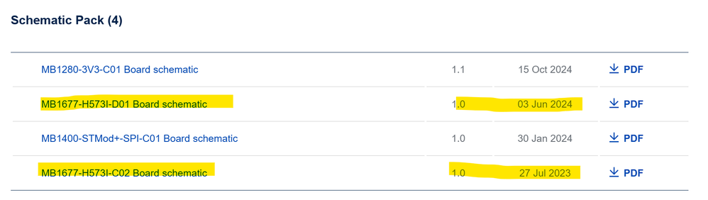

I'm planning to get STM32H573I-DK to evaluate X-CUBE-AUDIO-KIT Livetune because there are project examples for specific boards and this is one of them. I'll be using an STM32U5A9 MCU eventually and both have an M33 core. This should make it easier to port from one to the other. I see that there are two versions of STM32H573I-DK:
MB1677-H573I-D01 Board schematic has a WM8904 audio codec and MB1677-H573I-C02 Board schematic has a CS42L51 audio codec. This last one is marked as "Discontinued Product" by the manufacturer.
Do the examples for STM32H573I-DK work for either version of the board without any modification or does it require a specific version/codec?

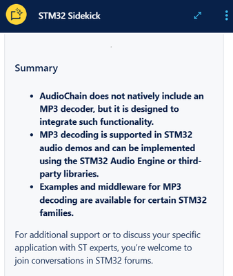

2026-03-31 9:55 AM
Thanks for this. Unfortunatelly my confidence on ST support regarding MP3 decoding has been less than optimal so far. The whole point of buying STM32H573I-DK was to evaluate the MP3 decoding of Livetune/Audiochain (for an M33 core). But according to your own sidekick there is no native support for MP3 decoding in Livetune/Audiochain. This makes me wonder about the purchase. I'll be asking another more specific question later ... right now I'm mentally exhausted. Again thanks.
