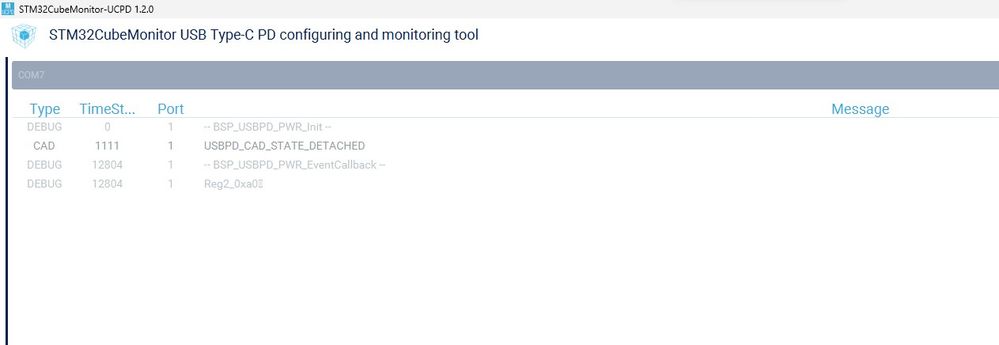

2023-02-09 10:12 AM
The following is the trace that occurs with my project which followed this wiki.
If I load the src1m1 project from x-cube-tcpp by selecting the ioc file in STM32CubeIDE, building it, and running it, I do not get anything in the trace.

Hello @AChin.3 (Community Member)
Please can you try the binary supplied in x-cube-tcpp for scr1M1 on Nucleo-G4 and let us know if it works ?

2023-02-10 6:35 AM
When I load that program I do not see my device available on ucpd monitor and I do not see anything on any trace - and there is nothing happening when I plug in the device.
I did identify a potential issue. I connected a dc power supply to cn3, but I connected it to the ground side of the header for a few seconds. I do not believe my supply dissipated any power into the device, but hardware issues are a potential culprit.
