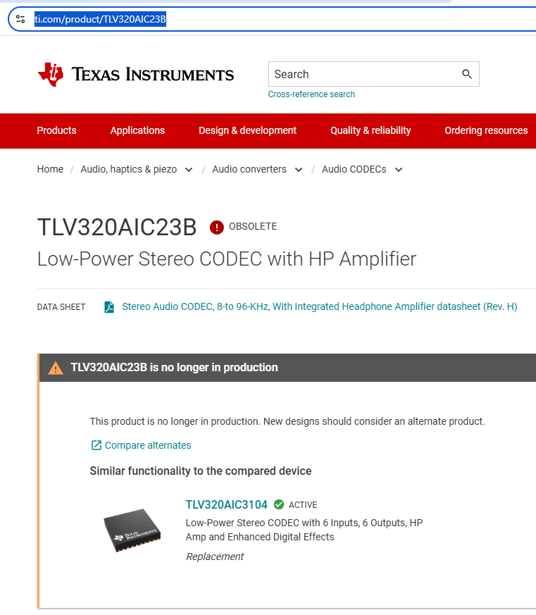

That would be governed by the TLV320AIC23B, which is a TI product - nothing to do with ST.
So you'd need to ask TI that question:
https://www.ti.com/product/TLV320AIC23B
And, as @LCE said, the TLV320AIC23B is obsolete - and no longer in production:

Anyway, the TLV320AIC23B is obsolete / end of life - are you sure you want to use that one?

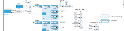

1. yes, using I2C and SAI in I2S mode will work fine.
2. yes, read ds TLV320AIC3204 ; depends on what you want use as Mclk ; typical is fs x 256 ,
so just use CubeMX , set clock tree and SAI to desired fs , check if its possible to get the fs x256 as Mclk .
ed
with clock at 98.33 M , you will be close:
cpu HSE can be 8 or 16 M , for example.
