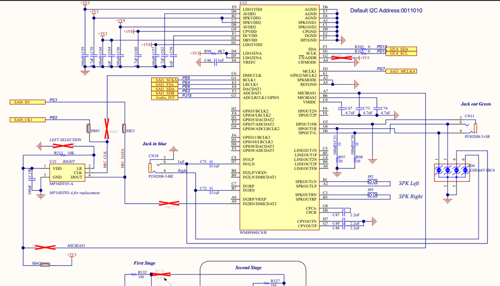

I am working on STM32H747I-DISCO Board and trying to bringup digital MEMS Mic (MP34DT05) which is integrated on STM32H7-DISCO Board.
I am trying to record random voice for 5 seconds and need to play back via audio jack out which is connected to codec also it is integrated on the board. I am sharing you schematic of the board as below:
MP34DT05 is connected to MCU directly with SAI4 Interface and Solder Brifdges are provided to connect via codec

1.MIC is shared by SAI4(MCU) and SAI1(codec). So to get PDM data which Interface I need to prefer?

@rabbani_sk wrote:
Can you provide any reference example to read the PDM data via this MIC using appropriate interface.
Since I am trying to get data via SAI4 interface but unable to get it.
The only example I can suggest is the one provided in CubeH7: https://github.com/STMicroelectronics/STM32CubeH7/blob/master/Projects/STM32H743I-EVAL/Examples/DFSDM/DFSDM_AudioRecord
Hope that helps
Hope that helps
