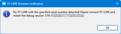

If you get the serial number wrong (or specify a serial number, and that particular ST-Link is not present), you get this error:
Is that what you're getting?
