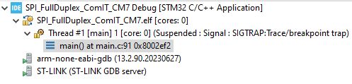

I have two NUCLEO-H755ZI-Q boards and I’m trying to run the SPI_FullDuplex_ComIT example on both.
One board breaks here (whether the software is built for master or slave):
The other board has no problem (whether the software is built for master or slave).

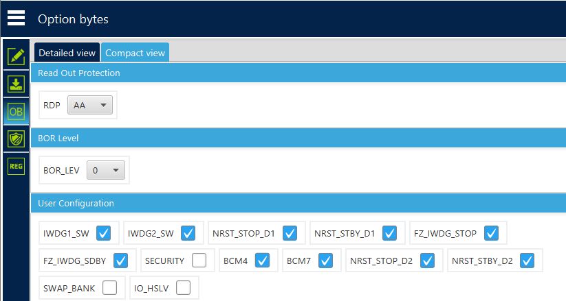

I looked at the working board and found both BCM4 and BCM7 are set, just like non-working board. The command
STM32_Programmer_CLI -c port=SWD -ob displ
showed no differences between the boards.

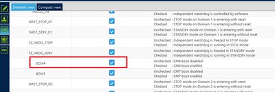

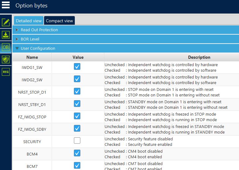

The log shows that CM4 is disabled.
Please use STM32CubeProgrammer in graphical mode to enable it:
The project is SPI_FullDuplex_ComIT_CM7:
