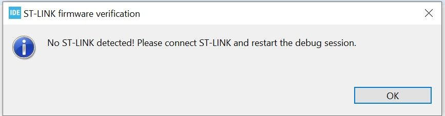

Maybe you can help me, I am not able to start debug session with STLINK-V3MINIE.

When trying to open a debug session, I get the message "No ST-LINK detected! Please connect ST-LINK and restart the debug session"
I tried >20 times, connecting on different USB ports, different USB cables, 2 different STLINK-V3MINIE. I tried to switch OFF the firewall.

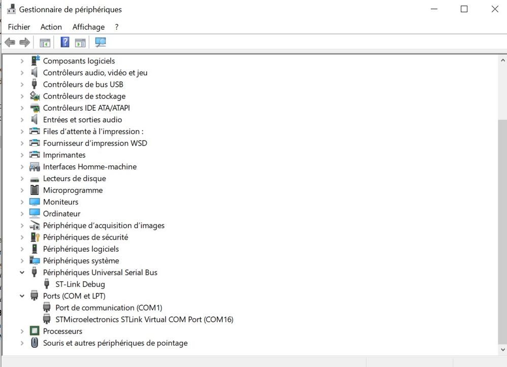

So can Windows itself see the ST-Link? ie, does it appear in Device Manager:
Note the PS there specifically for ST-Link V3

In Device manager, it appears as "ST-Link Debug"- driver date 01.04.2021, version 2.2.0.0
and "Virtual COM Port"
It seems there is no error there.

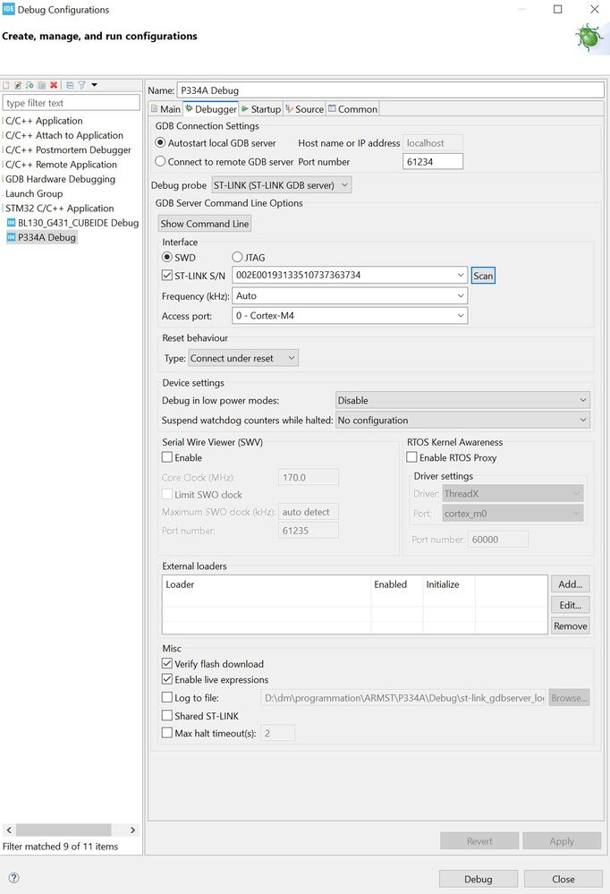

When I open the menu "Run>Debug Configurations" from STM32CubeIDE , tab "Debugger", I can read the debugger S/N (result is 002E00193133510737363734).
I tried with and without USB hub, USB2 and USB3 ports on computer, it's always the same, in device manager it shows the items, in update tool it shows the STLINK-V3MINIE, but debug session always stop with the message "No ST-LINK detected! Please connect ST-LINK and restart the debug session".
Can you explain why the old STLINK-V3 are performing well, but the new STLINK-V3MINIE fail? Is there an important hardware/software difference other than the USB-C socket on the STLINK-V3MINIE and micro-USB on older types?

If it can read the serial number, then CubeIDE can see the ST-Link.

Yes sure, only Only STM32CubeIDE is open. I checked task manager too, restart computer too. Is it useful to try re-installing CUBE-IDE?
2025-01-31 5:36 AM
So the ST-Link is being seen correctly by the IDE, but as soon as you start the debug session, it disconnects...

Hello Kraal, the issue occurs earlyer, the ST-Link MINIE appears unconnected while trying th start a debug session, but it correctly connected and recognized for other actions (enumeration in device manager, S/N reading, upgrade it's firmware)
