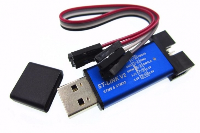

Are these authentic or clones?
Watch that you're powering pins 1 or 2 with VTarget so as to power the buffers.
2021-02-10 4:39 PM
"Are these authentic or clones?"
+1

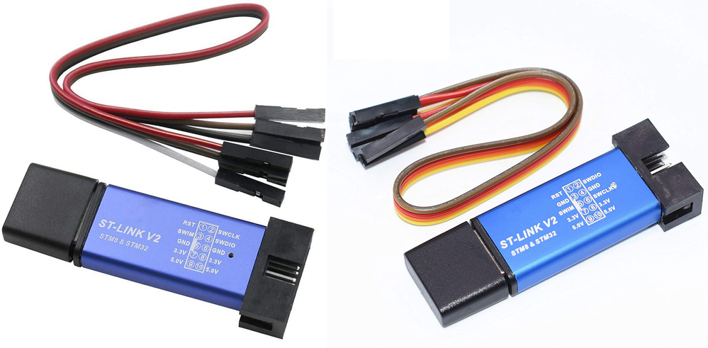

If you've got cheap clones like this from ebay or the like:
beware that there are at least two different pinouts on otherwise identical-looking products!
EDIT
Here you go:
Click the image to enlarge - Look carefully at the two pinouts!
