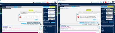

I have tried both SWD and JTAG with all possible reset methods through the CubeProgrammer and IDEDebug configuration:

I kept getting one of these two errors:
I then removed R501 and still saw these errors.

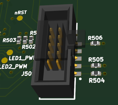

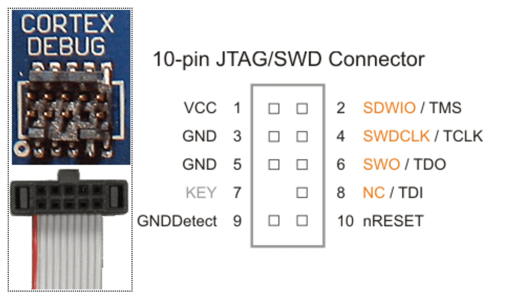

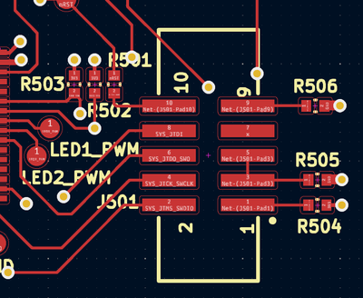

2025-08-14 10:33 AM
Thanks for the quick reply,
On your 10-pin JTAG/SWD connector where is your nRESET signal routed? Pin 7 of the STM32 or Pin PB4? Does this matter?
I can confirm that the pin header is not mirrored or rotated improperly:
The key is on the same side as pin1.
I checked my wiring from ST-LinkV2 through to the board. I am using CN3 on the ST-LinkV2 through an ARM-JTAG-20-10 to my board with no hacks or modifications to those wires.
Any other reasons?

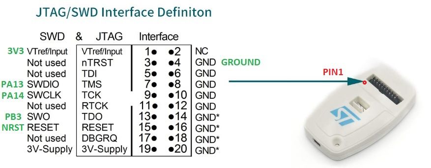

2025-08-14 11:06 AM
Not sure why you're involving PB4 the NRST/NRESET Pin 7 of the STM32F4 looks appropriate
Make sure you've identified Pin 1 correctly, one of you screen shots reports 0.01 V, so no power to buffers there.
2025-08-14 11:07 AM
With the STLink disconnected, does the nRST line go high? Does your STLink with the 20-to-10 pin adapter work on other boards?
2025-08-14 11:13 AM
Double checked that and it is correctly going to pin 1 of the ST-LinkV2.
