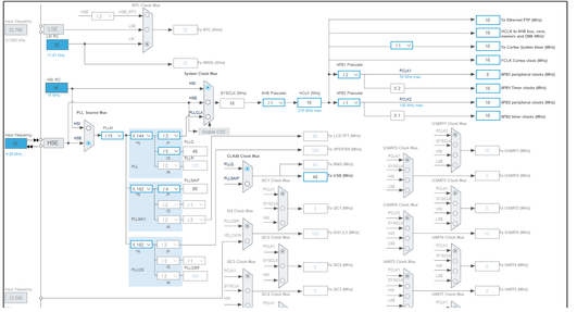

I've come here for a issue I failed to debug. My setup is as follows: I have a NUCLEO-F767Z development board and im debugging/programming it through the onboard STLINKV2 with SWO enabled. I am simply just trying to get a USB device to enumerate. I have configured the USB_FS host to the drive VBUS through pin PG6 where the USB power switcher is on the nucleo. My clock configuration is shown in the attached image. When plugging in a USB mouse (that works on my PC) through a USB A Female to USB Micro Male adapter, the SWV console prints forever:

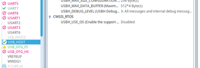

2. with SWO running, you could set the usb "debug messages" to 3 , maximum, to see all:

2. The output I attached was with debug level 3 (wish it gave some more info)
