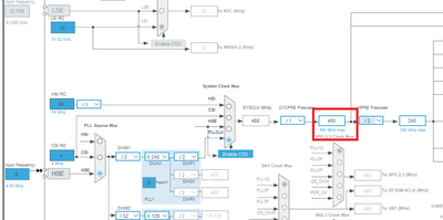

I did the exercise with CubeMx based on the source code you shared and don't see any issue with these parameters you are in the specifications:
So I don't see how the chip was burned! I suspect the issue is coming from something else..
