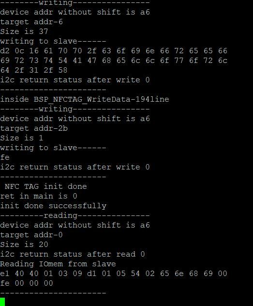

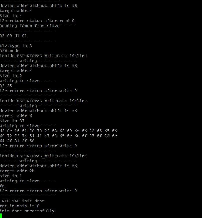

2021-08-27 12:54 AM
Thanks for the suggestion. I made the necessary changes and now I2c is writing without any return errors.
But I don't see the tag updated on NFC. I'm using NFCTools mobile app to scan, and the tag is not updated.
I'm writing a media type tag from program to NFC.

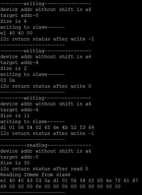

2021-08-27 2:01 AM
This the NFC content I'm reading after my write function.
Im writing media type tag, whereas, there is already an existing text type tag which is not updated after my write.

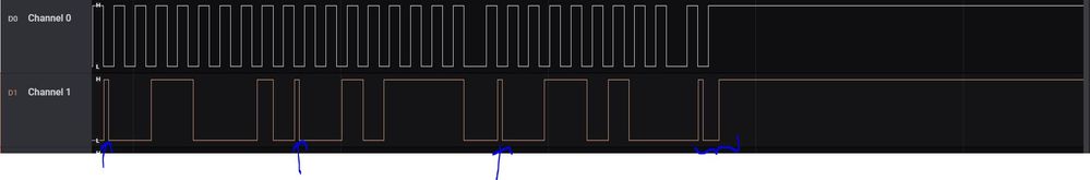

2021-09-03 1:32 AM
This is how I'm seeing on logic analyzer.

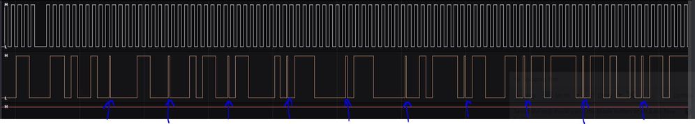

2021-09-03 1:36 AM
2021-09-03 1:43 AM
can you share the logic analyzer trace file so that I can see the full frame and do some analysis? (Please indicate whether this is Salae or digiview or picoscope, or other tool)
Thanks
Rgds
BT
